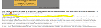

Suppose to sell my bike today (pending sale) so looking for quick response. Don't have time to search.
Have integrated tail and flush mounted sides. Earlier the season, I removed my seat, black and blue wires below got caught in underside of seat and I pulled them out of the connector.
Have another bike so never got around to fixing it yesterday / today. I've reattached the wires but now the right side tail and front lights flash fast. I checked the fuses under seat, all good. Strange thing is when I pull the 7.5A fuse (Meter Tail, License PO) they blink at normal speed (obviously red tail lights out).
Any thoughts? Any fuses in the rectangular block (circled yellow below) that comes with the taillight?
