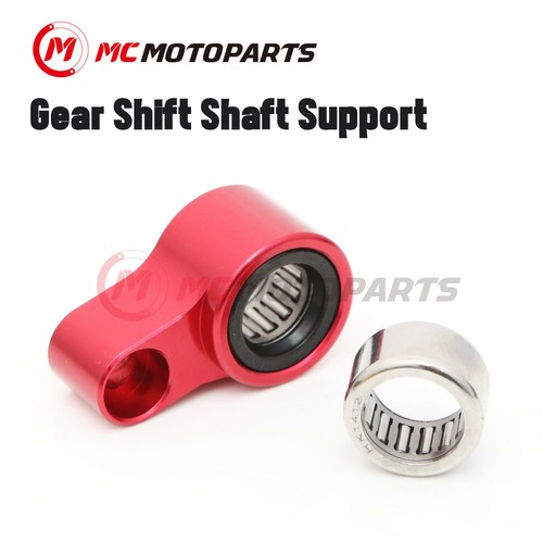

Btw, in case anyone else having transmission issues stumbles through here, I swapped my clutch lever for an adjustable one and adjusted the freeplay to the minimum (just over 10mm) and it's made a huge difference. I still sometimes get a notchy feel from the shift lever going from first to second, but it's a lot better now. Next up: RaceTorx shifter support and slightly tightening the chain.

Also got the RaceTorx Shifter support. It did make a noticeable difference. Also adjust the gear lever height and chain slack. Adjustable levers will help with the free play/bite point. Ps a to tight chain will cause a slow gear enchantment, to much slack will cause for a clunky and inaccurate shifting gearbox.

I also got a shift support and it fixed my problem. My bike would occasionally go into neutral going from 1st to 2nd. With the support installed, it hasnt happened again.The gear changes feel more pronounced.
I didnt want to spend so much on the racetorx one, so I bought this eBay one for 25 bucks. Its great quality, I recommend it.

@ N n3xus - did the one in the link you posted fit without issue? When I select the 2019 CBR650R it states its not compatible.
