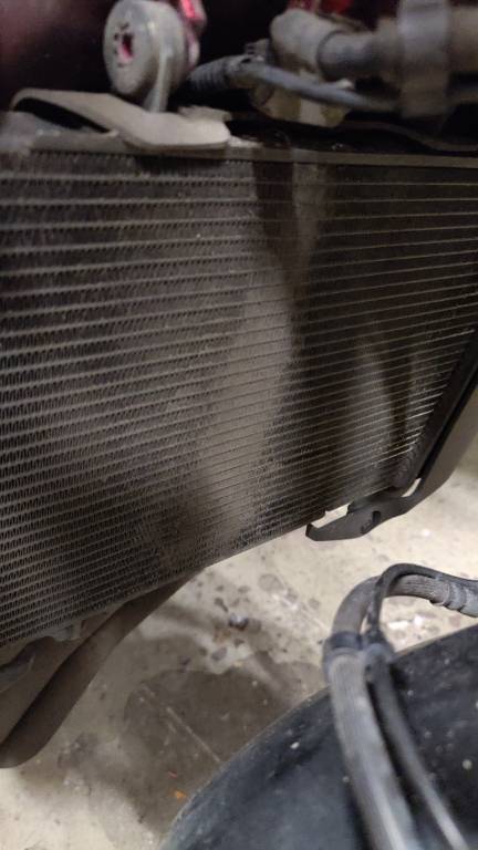

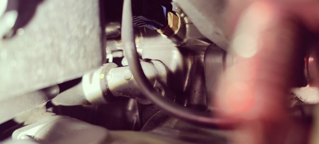

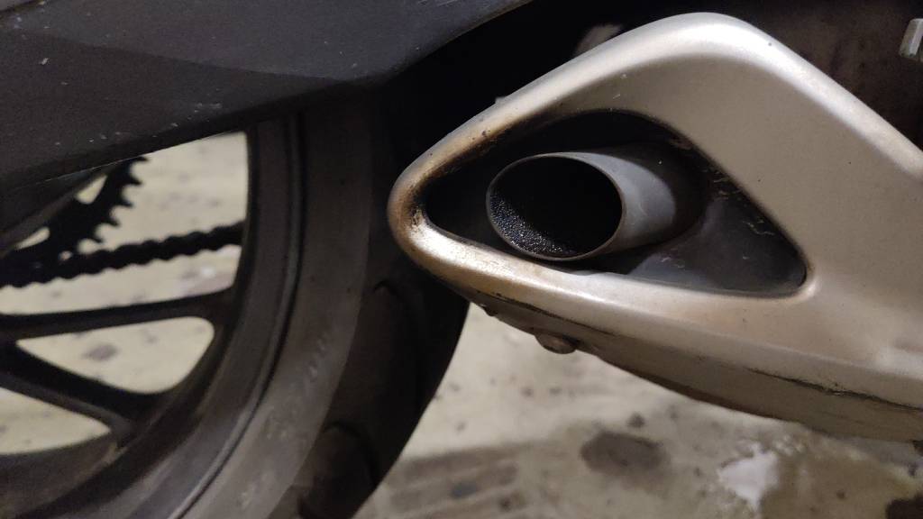

So I got my air filter box cleaned and changed my spark plugs to iridium:
Exhaust leaks badly condensation:
Coolant check;

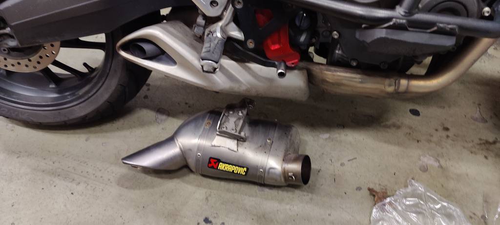

Akrapovic exhaust installed:
What a pita to get the old exhaust manifold bolts off at this high mileage, All bolts/studs are now greased with ceramic grease.

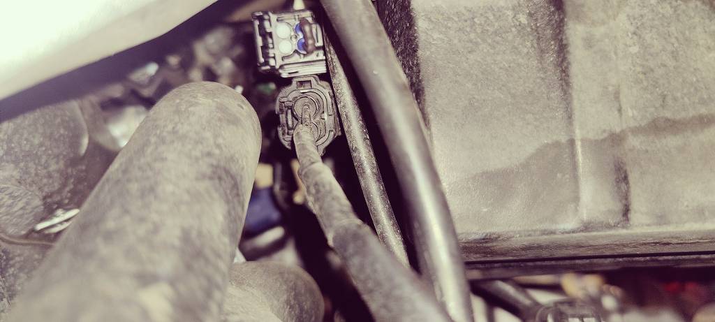

So I installed a oxygen sensor delete on my CB650F now.
Fully deleted it. O2 sensor blank oil drain plug installed.
