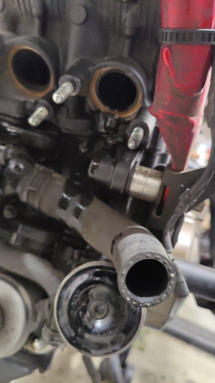

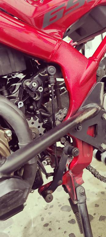

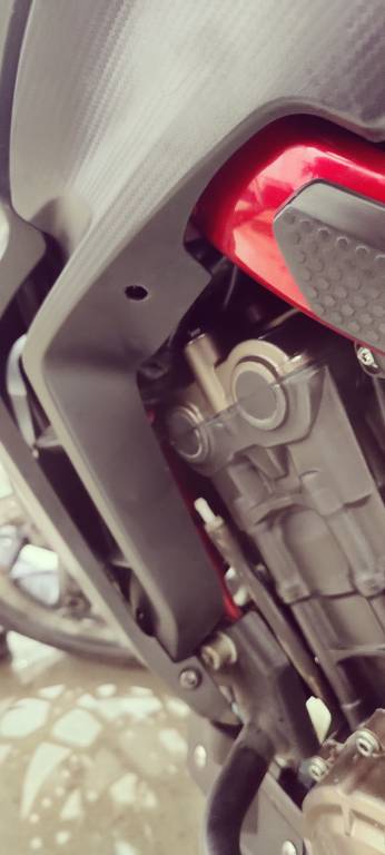

Used 4 hands and 2 jacks to get the engine back to its home:
Maybe use the gear sensor to install a non rpm gear indicator.
I got the engine in.
- all coolant hoses fit.
- all coolant steel connections fit
- all intake rubbers fit
- all spark plug cables fit they are different spark plugs but, the cables fit
- EOP fits
- ECT fits
- CKP fits
- alternator not sure but, it came without one so put the old one over
- all coolant gasket fits
- starter fits
- TB fits
- clutch cable fits
- AIS fits
- exhaust fits
- VSS fits
- engine hangers fit
Need to redo:
- Neutral switch (2019 does have gear indicator) wiring only redo (LG wire)
- gear shifter stabiliser

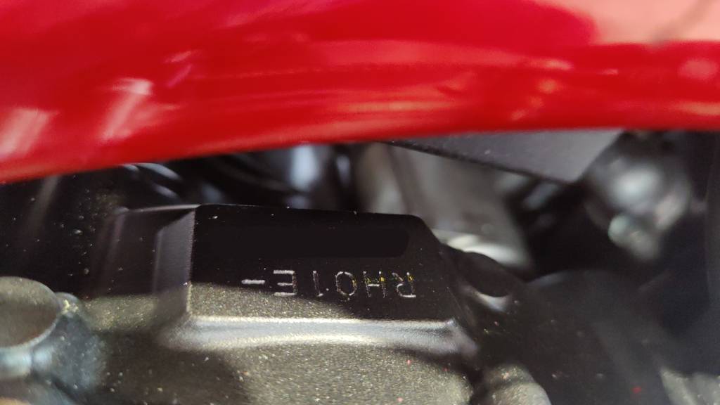

Engine starts, Missing clutch and housing does the old type fit?
Both SHOULD fit, color seems to be the only difference. But at that mileage there should be fairly significant wear in the basket and plates, you may want to replace with a used basket.

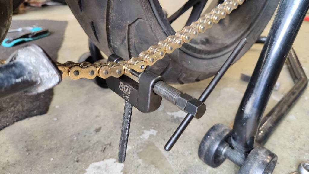

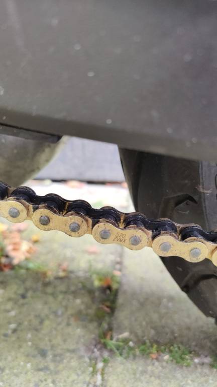

So I have these sprockets on my CB650F for a 520 chain conversion

Its ok, another guy runs this chain after 30000km on the same bike no play on the chain.

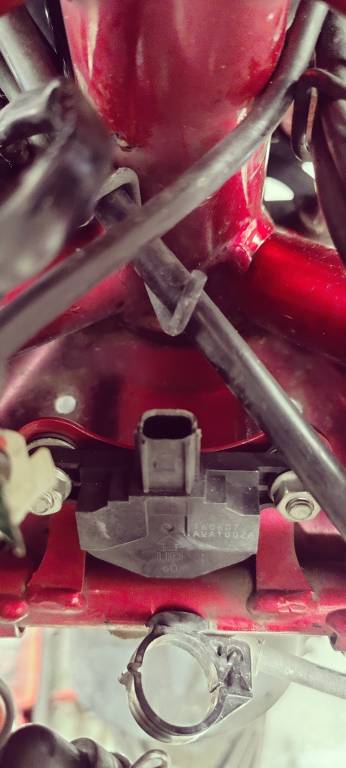

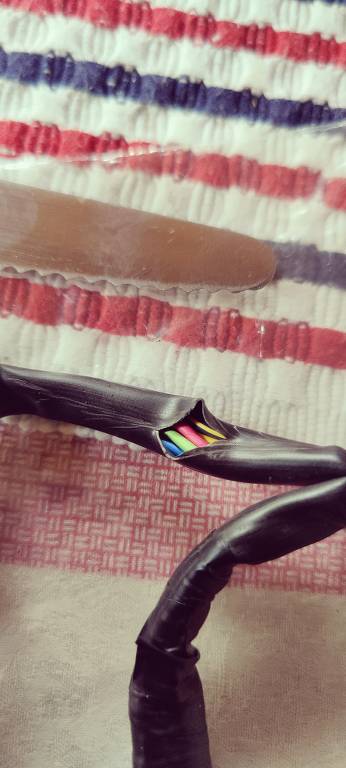

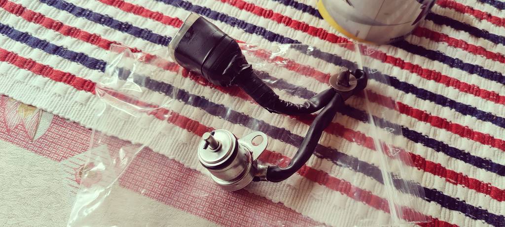

Got my neutral switch in:
